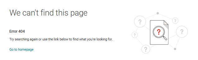

Additionally, I was unable to locate the design files for the TUSB211 EVM on the website. Would it be possible for you to provide these documents for my reference?
  • The design files are now available for download. However, I still need to confirm the design differences between the TUSB211 and the TUSB211A. Additionally, if the CD and ENA_HS pins are not utilized in my design, is it acceptable to leave them floating?
