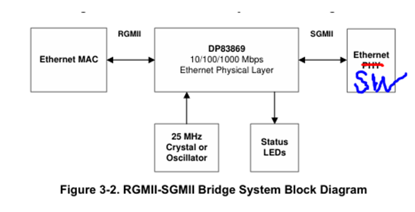

Dear,
Here  is a question about TI PHY chip DY83869.

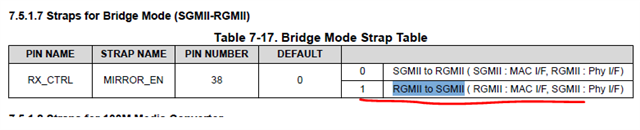

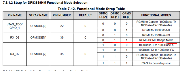

I am going to  use this chip as RGMII-SGMII bridge mode, while not connecting to an ethernet PHY. It will connect to an Ethernet switch with SGMII port. Like below pic.,
Q1, I guess it works, right?
Q2,  Anything special I need take care of for the application like this?
Thank you.
