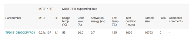

Hi Team,
I would like to check if we have FIT/FMEDA document for ESD?

Hi Roy,
Please see below for FIT. This can also be found on ti.com under Quality & Reliability.
Hi McKenzie,
What is the mechanism for calculating in the page?
We need the RAW fit and failure mode like be document.
Roy
Hi Roy,
Since the TPD1E10B09 is not a functional safety device, we do not have information like the document provided. For failure mode, the device should follow the below:
