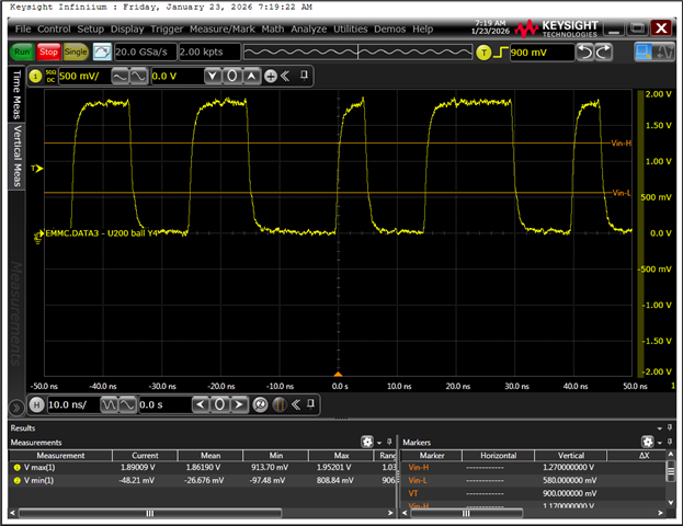

We have made a new product serie with the AM6254 microprocessor. As flash memory we have chosen an eMMC from Macronix, attached to the MMC0 channel on the AM6254.
During read from the eMMC we are seeing some over- and under-shoot on the data signals, where the values are just on or above the limits (Figure 7-1 in the AM625 datasheet) for the MMC0 pins.
The attached oscilloscope picture shows eMMC.Data3 measured as close to the AM6254 as possible.
The over shoot voltage level is measured up to 2.25 V, and under shoot level down to -0.34 V. The over and under shoot time is measued to totally 2.6 ns out of 10 ns period time.
So levels are just on / above limits. (High level: 1.8 V + 20% = 2.16 V; Low level: -0.36 V, Time 20% of 10 ns = 2 ns)
How concerned should we be regarding the levels of the over- and under-shoot??

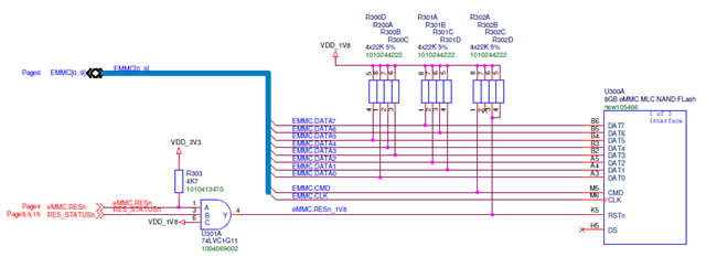

    Could you share the schematic implementation for a quick check
    Can you confirm the probe point - near to the memory of the SOC
    Can you also confirm the ringing is not influenced by probing  or ground connections (confirm you are using a short probe)
    Can you measure a similar waveform for any other peripheral and compare the waveform.

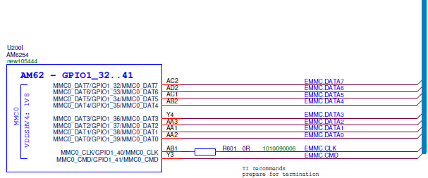

    Schematic snip of eMMC connections.
    Connection to the eMMC
    Connection to the AM6254:
    The signal is measured as close to the AM6254 as possible on the backside of the PCB at a via. The distance to the ball of the AM6254 is less than 2.5 mm.
    The signal is measured with an active probe, so the ringing is not caused by a long GND loop.
    Regarding a similar measurement the below signal is the same signal and measured at the same via, but with another manufacturer of the eMMC. (Unfortunately this manufacturer couldn't deliver the eMMC, due to the allocation situation on the memory marked.)
    The eMMC signals are routed with 50 ohm line impedance.
