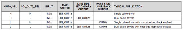

There are several configuration pins to define the input/output path for video. When a path is defined, can the other pin be left floating?
Example: OUT0_SEL=H, SDI_OUT2_SEL=L; this will put the device in Dual cable drivers mode. Can we leave the host side loop-back OUT0p/n be left floating, or do you recommend defining these pins.
Same question regarding the LMH1297, if we configure SDI_IO as input and OUT0 as output, can we leave SDI_OUT floating?
    For LMH1228 unused OUT0p/n, you can leave these floating. Please make sure SDI_OUT2_SEL and OUT0_SEL are not asserted. There are internal pull up and these would disable these outputs.
    For LMH1297 unused SDI_OUT, you can leave these floating. And you can use pin control or through SMBus to power down the SDI-OUT.

    To enable SDI_OUT1 and SDI_OUT2 it need a H on OUT0_SEL and a L on SDI_OUT2_SEL. so I should not leave SDI_OUT2_SEL floating.
    In any case I rather have them hardware defined. So I will externally pull SDI_OUT1 up with a 1k (on top of the internal pull-up), and SDI_OUT2_SEL down with a 1k. As I understand from your previous message, in that case I can leave the loop-back output OUT0 floating.
    Please confirm my statement.
    Correct, SDI_OUT2_SEL is internally pulled high by default (SDI_OUT2 disabled) so you need to pull it low to enable SDI_OUT2.
    Is this a typo "externally pull SDI_OUT1 up with a 1k (on top of the internal pull-up)", and should be OUT0_SEL? You can pull OUT0_SEL high to VIN using 1K and leave OUT0 floating.
