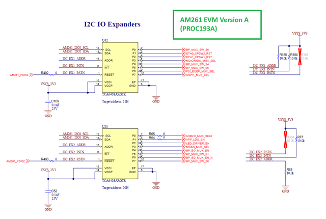

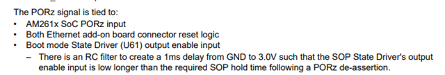

    I just went through and compared the schematics of both Version A and Version E2 boards. I found a major difference between the two schematics.
    In Version A, there is a connection from the PORZ switch to the IO expander reset pin, but this connection is not present on the Version E2 board. Could this be the reason for the issue observed on the Version E2 board?
    Can I connect the PORZ switch connection to R191 and R364 to check this on the Version E2 board?
    Akshay
