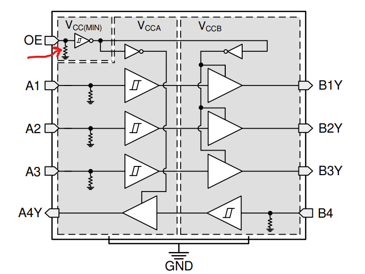

Hello, can you provide the value of the internal pulldown resistor on the OE line?
It is not provided in the datasheet.

Hello Csaba,
Since OE is consider an input pin, the pull-down resistor will be 5Mohms.
