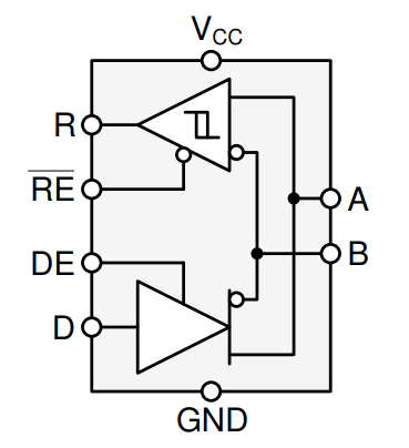

Hi team,
Does THVD2410DR support loopback testing?
Leo
This is a half-duplex transceiver, i.e., the bus inputs and outputs are always connected together. When DE is high and /RE is low, then you have a loopback.
Please note that it is not possible to have a loopback while disconnecting the driver from the bus.
Hi Leo,
Yes. Every RS-485 half duplex transceiver has this internally.
