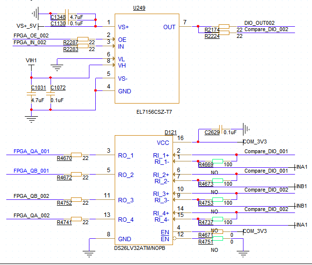

In the test circuit ,the el7156 line driver is used to drive signals ,and the DS26LV32 is used as a comparator.when the el7156 is set to tri-state (high-inpedance),the ds26lv32's RI- input is biased at a fixed 2V (INA1=2V  ,INB1=1V , R4669/R4673/R4753/R4737 no-nop).The following behavior is observed on the RI+ PIN :
1. R1+ is floating ,then check RI+ 2V voltage is present .
2. RI+ is pulled down to GND with a 1k resistor ,then check RI+ 2V voltage remains.
3. R1+ is pull down to GND with a 100R resistor ,the voltage drop to near 0V.
why does a voltage appear at the RI+ pin? we look forward to your reply.

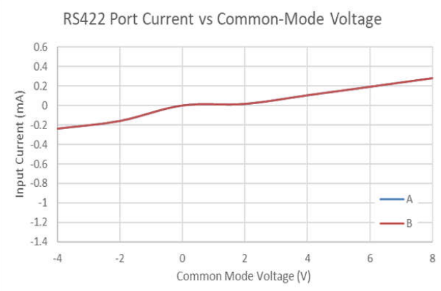

  • The datasheet specifies a typical input resistance of 5 kΩ, and the inputs might have additional pull-up/-down resistors to detect disconnected inputs.
    The AM26LV32 is a similar device with the following typical characteristic (the DS26LV32AQML might behave differently):

  • Hi Yulong,
    Here is simplified diagram on the internal receiver input (A pin=RI+, B pin=RI-):
    Additionally, there is some equivalent, differential resistance between the RI+ and RI- pins. Hence, why when you bias one input, the other follows closely.
    Because RS-422 transceivers are designed for a particular differential communication at a certain common mode voltage. In normal operation, both pins RI+ and RI- are expected to be driven.
    Ethan
