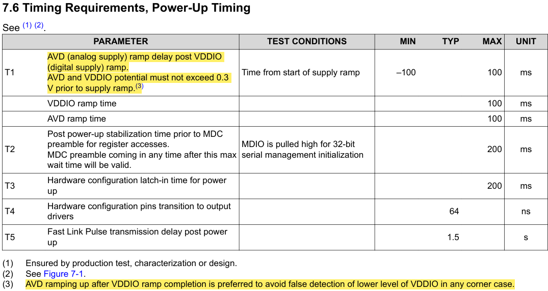

1.About Power-Up Sequences
There is a description of "AVD (analog supply) ramp delay post VDDIO (digital supply) ramp. AVD and VDDIO potential must not exceed 0.3 V prior to supply ramp." in the table of 7.6 Timing Requirements, Power-Up Timing in the data sheet of DP83822H, and there is "(3) AVD ramping up after VDDIO ramp completion is preferred to avoid false detection of lower level of VDDIO in any corner case" in the annotation.  There are questions from a customer about this content. Please answer the following four questions.
1)Can we understand the meaning of these words as "Either AVD or VDDIO can be activated first, but after one of them is activated, the other must be activated within 100 ms. However, it is preferable to start the AVD after the VDDIO is started to avoid low-level false positives of the VDDIO."?
2)From the content of the comment (3), it is understood that it is preferable to launch AVD within 100 ms after VDDIO is launched, but what are the consequences and concerns if this is not observed?
3)Looking at the circuit diagram of DP83TC811EVM on the evaluation board, it seems that the rising order and timing of VDDIO and AVD are not taken care of. Is there any problem?
4)For the circuit under design, I am thinking of starting up VDDIO and AVD at the same time as the evaluation board in order to reduce cost, but is it necessary to follow the comment (3)? Is it all right if we start up at the same time?

  • Hi Imai-san,
    I checked with my team, this load capacity is fine as long as it is verified with the crystal manufacturer that the customer is using. There is no problem using 2 capacitors in parallel.
    Regarding your questions about Power-Up Sequences:
    • Where is this excerpt from? I did not see it in our datasheet.
               It is saying that while either the VDDIO (I/O supply) or AVD (analog supply) can be powered first, it is recommended to power VDDIO first. The second supply powered should also be powered within 100ms of the first. Powering VDDIO first is done to avoid false detection of lower level of VDDIO. Although it is recommended to power VDDIO first, it is OK to power AVD and VDDIO at the same time. I also assume you meant the DP83822EVM and not the DP83TC811 EVM! Let me know if that was intentional.
    Greg
