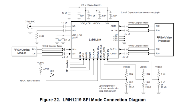

Dear Team,
I have one SDI to Optical desing same as TIDA-00428  referance desing,
i have some issue when i connect 6G-SDI camera on my POC board .
6G-SDI input from camera to LMH1219 not working - HEO and VEO - 0 so issue at Out0 not matching eye diagram requirement .
when i connect PC monitor with 3840x2160 HDMI to 6G-SDI converter and to LMH1219 its workgin and gives proper HEO and VEO reading and all work .
some time it gives short flicker on video .
any idea what could be the reason ?

    Can you please share your schematic and layout for review?
    Instead using I2C to configure LMH1219, can you switch to pin strap mode? Are you still seeing the issue in pin strap mode? Does the LOCK_N also go low to indicate a lock condition?

  • Dear David,
    i try with strap mode Lock_N - low in both case we have Lock - problem is some time flicker comes , i make test for multiple times if i have proper video without flicker it will work as expected but some time it gives flicker when i turn off and on again , i think there is some issue with 6G-SDI signal because when i use some other device with SDI loop out it works as expected i must order one converter and evaluate this and will inform you .
    refer below schematic - i had some issue on LMH1219 - VDD_LDO pin i must not connect this to 2.5V .
    Nikunj

  • Dear David ,
    i change the termination , at IN0+ remove the 75Ohm pull down and IN0- 75ohm to GND and now i able to make it work with camera ,
    thank you for your support,
