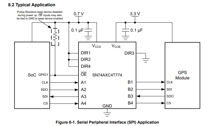

I am using SN74AXC4T774PWR for my SPI interface between MCU and my SoC.
Whether pullup resistors are required at the CS, CLK, MISO, MOSI signals? I refered the below image from the datasheet and there are no pull up resistors used here.
Shyam
  • You need pull-up or -down resistors on all lines that could be disabled by the driving device. In general, /CS is always driven. I do not know what your SPI master does with the CLK/SDO signals; if they are disabled while the SPI bus is inactive, you need PU/PD resistors on A1 and A2. The SPI slave's SDO output is typically disabled when /CS is high, so you would then need a resistor on B3.
    Note that the TXU0304 is simpler and cheaper. (It would also need resistors.)
