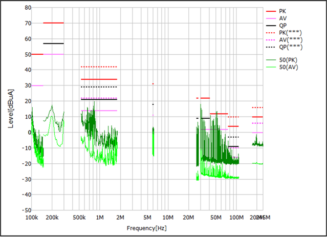

My customer tested EMC CE current test in the lab, but the test result was fail. (Over the bandwidth of 20Mhz)
Customer's product is used TCAN1473CDMTRQ1.
Customer used TCAN1462-Q1 in their previous product before but customer did not see the results like this.
Could you check the reason of this failed result although TCAN1462-Q1 has no problem?

  • Dear Michael,
    Here are the feedbacks from my customer ;
    • Ensure the power supplies do not droop. For example, confirm VCC is at 5 V when measured at the IC pin, and not somewhere near 4.75 V.
      -> Power supply is stable. measured as 5V at anywhere.
    • Ensure total bus load or any other nodes connected ≤ 50 pF. -> TVS(7pF)+CAP(7pF) = TOTAL 14pF
    • Ensure the previous passing case did not include CMC, similar to the NC CMC as this case. Verify if it passes with CMC. Ensure CMC of 50 to 100 uH passes. -> TCAN1462 : Passed without CMC. TCAN1473 : Passed only if CMC is added. Below screenshot is the image of passed results of TCAN1462.

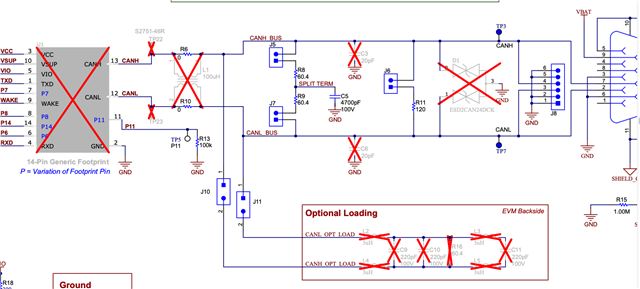

    • Ensure the previous case includes a similar termination as this case (or help confirm any / all differences in from the passing case). Verify if it passes with 60 ohms split termination at both ends of the bus for an effective bus termination of 60 ohms. -> TCAN1462 is recommended as 60ohm, and TCAN1473 is recommended as 2.2Kohm in EVM. So it is different.

  • Dear Michael,
    Thank you for your support.
    - Could you help verify the device passes with a similar termination from the passing case?
    => You mean that It is necessary to test with 60 ohm resistor instead of 2.2kohm although EVM's recommendation is 2.2kohm?
    Chase
  • Hi Chase,
    Yes, I am recommending an effective bus impedance of 60 ohms. See below example from the EVM, thanks.
    Michael.

    Customer said that it is not easy to test with 60 ohm because it is dedicated value in test process.
    Is there any internal difference between TCAN1473-Q1 and TCAN1462-Q1? (exclude termination resistor)
  • Hi Chase,
    No known major difference internally as I suspect concerns are externally related.
    I.e, noise may be expected with impedance mismatches and may further confirm with the passing device + the mismatched impedance case as well, thanks.
