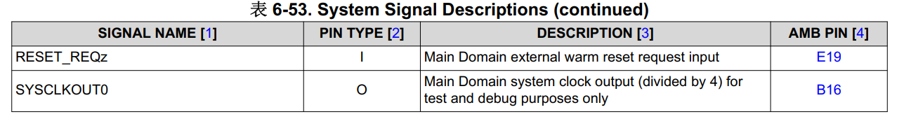

AM62A7-Q1: RESET_REQz reset MCU domain
Part Number: AM62A7-Q1
Hi,teams
When the system was operating normally, I used the GPIO in the MCU domain to pull down the RESET_REQz signal. I found that not only the A core was reset, but also the R core was reset (DMR5 domain was reloaded). The manual describes this signal as the reset for the A core. I would like to know how I can only reset the main domain.
Additionally, I tested when RESET_REQZ was pulled low, the power supply of the PMIC remained stable, and the MCU_PORZ signal remained at a high level.
