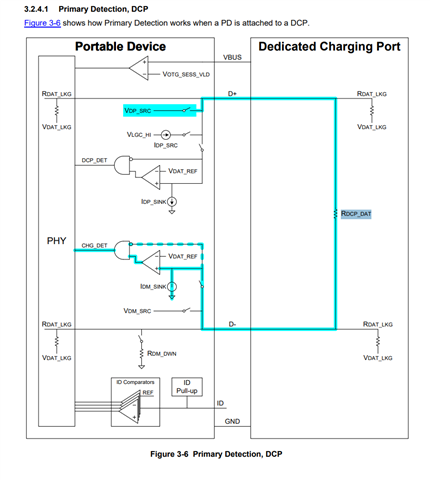

Hi team,
How can TUSB2E221 support DCP mode?
I assume 200ohm for CDP and 0ohm for DCP should be toggled but there is no GPIO if customer use USB2 PHY configuration (I2C isn't used). Please help to answer with simple block diagram if DCP is achievable for clear understanding.
