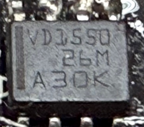

    • Can you also share images of the top markings of both of these devices?

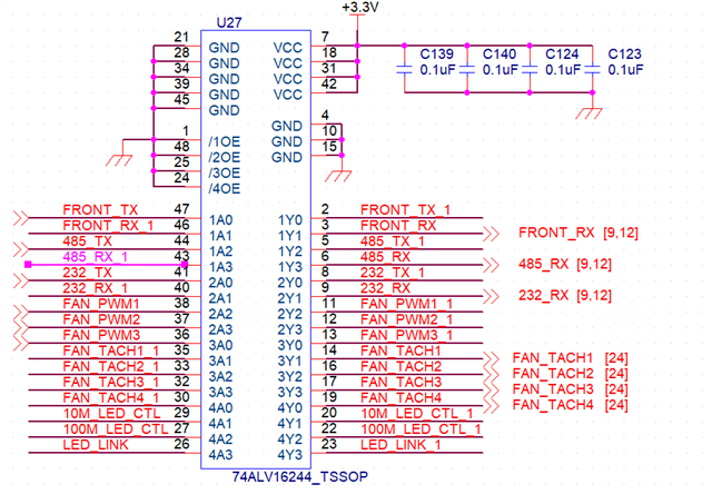

  • Let me answer your questions one by one:
    1. I am using two 485 ICs because I need both RS422 and RS485 functions to coexist in the same design.
    2. By “pull Low,” I mean that when using the RS485 function in this circuit, the user will only connect the PC through U2
    1. The marking is shown in the first image.
    2. The circuit is shown in the second image.
  • Thanks for clarifying. I missed that "EN_485" net label, which means you still control whether that transceiver is driving or receiving.

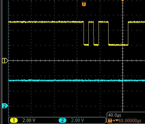

    Please share a waveform (or exact A and B voltages) of U2 and of U3 when you expect the RX output to be low. My guess is that one of the transceivers considers the bus to be in an idle condition, where R will be high:
    Please note that the receiver will be high impedance when it is disabled.
    The first image shows the waveform of U2 RO during operation, and the second image shows U3.
  • When EN_485 is low, both U2 and U3 are driving the 485_RX_1 signal. When they try to drive different voltages, the resulting voltage will be the average. (And the short-circuit current might damage both devices.)
    You have to control the /RE inputs of both receivers separately. Alternatively, combine the two RO outputs with an AND gate like the SN74LVC1G125 (and add a pull-up resistor to U2's RO output).
