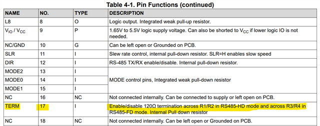

We are designing a product which provides RS232/422/485 which shall be software configurable based on THVD4431A.
Need to configure THVD4431A for RS485 Half and Full duplex, RS-422, and RS-232 with RTS,CTS.
