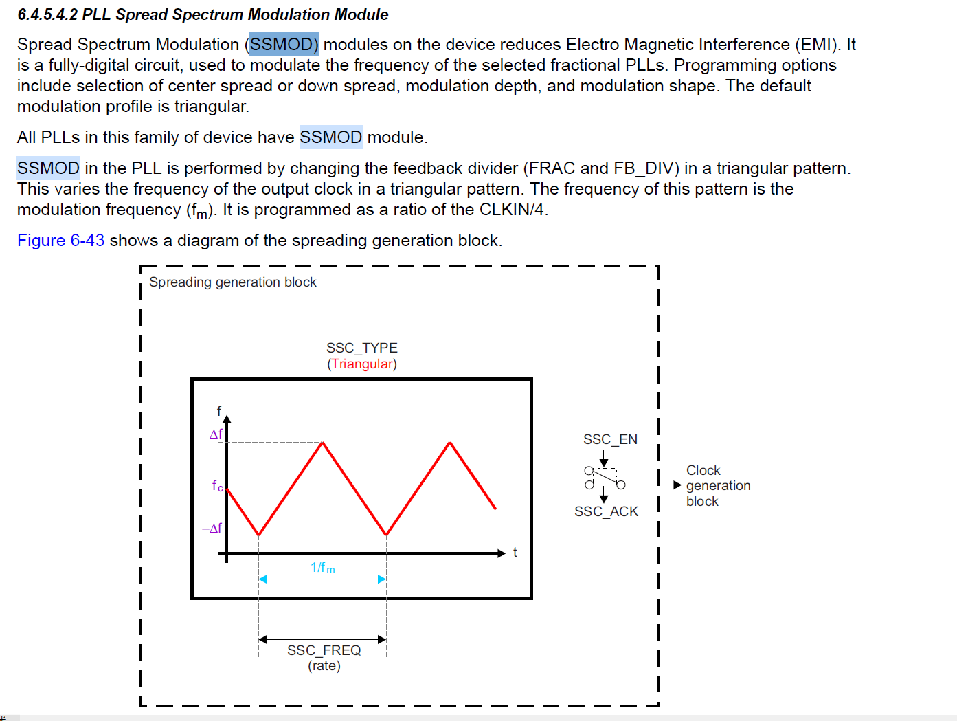

we are using AM62A34ASMSIANFRQ1 , the DDR4 clk is set as 800MHZ ,and we find that the harmonic frequece 1.6G is above the limit during EMC RE test .
we had enable DBI . and we find the PLL support SCG , can we set SCG enable? how to set it ?
  • Spread spectrum is not supported for DDR PLL.  You can possibly mitigate the harmonics by slightly changing the DDR frequency to 790MHz for example.
    BTW, speed grade of the AM62A you are using is capable of max DDR frequency of 1600MHz.  So you could run at 1580Mhz for example.  Use the DDR Register Configuration Tool to change the DDR configuration for the new frequency: dev.ti.com/.../

  • hi JJD ,Yong
    thank you for your quick feedback .  the DDR is running at 1600MHZ in my board ,not 800MHZ
    Finally , we plan to optimize the layout instead of changing DDR clock .
    thank you .
