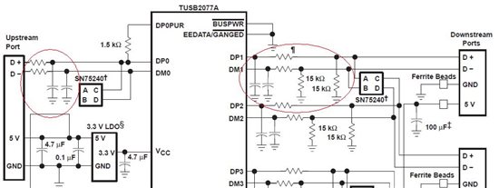

I'm having some trouble getting the TUSB2077A hub to work.
My schematic is shown below.  It's a close copy of the reference diagram from p13 of the datasheet.  This is to be used in an "installed once" setup, so I don't need power management for the ports of the hub.  There are a few additional differences that I don't think would cause the behavior I'm seeing (described below)

  • Hello Kailas,
    Tie all the /OVERCUR# terminals to 3.3-V through a 10K resistor.
    Make sure you active low Reset signal has a duration between 1ms and 3ms on power-up and that the clock source for the hub is stable before the Reset is de-asserted.
    Add the passive components on DP and DM lines as shown below.
    After you connect the hub to your host, are the clock and Vcc lines still stable?
    Regards.
