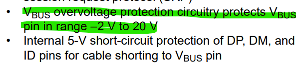

We face the following problem inside our application. Our system provides the possibility to act as an USB 3.X device including USB-PD handling, which is not handled inside the device itself - this is done via a special additional electronic. As we could reach up to 20V here, it is not possible to connect the VBUS directly to the VBUS pin of the TUSB1210 and the other electronics on our used SOM (limited in terms of Umax). But we have connected the ID Pin (Pin 23) to a dedicated MCU, which we could control dynamically in respect to the handled sink/source of our USB-PD controller. No we face the issue that we can't connect our system as an USB Device to another Host. USB HOST mode (connecting e.g. To a flash drive) is working.
Is there any possibility to force the TUSB1210 to USB device Mode without connected VBUS?
