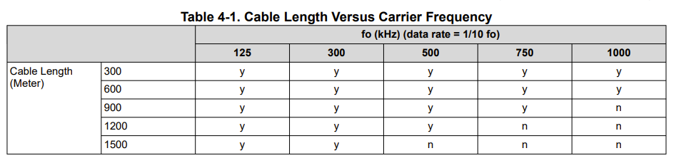

In addition, I saw that the THVD8000 has this chart about length vs carrier freq in its design guide, shown below. How applicable is this chart towards the THVD8010? I know that the thresholds are higher on the THVD8010, but is there any documentation or table that refers to the max possible lengths with the 100 - 300kHz carrier frequency? Would 1000m still be possible with 300kHz carrier?image.png

    Table 4-1 can loosely still apply to the THVD8010. We do not have a table similar to this for the THVD8010. The lower carrier frequency will still help enable longer distances similar to the THVD8000. The greater threshold on THVD8010 can also make it less sensitive to noise, which will improve its ability to communicate over long distances. I would expect THVD8010 to communicate fine at 1000m at 300kHz carrier frequency while following our design guide principles. I would also recommend this guide which has more detail and equations to help design the best system: https://www.ti.com/lit/an/slla600/slla600.pdf

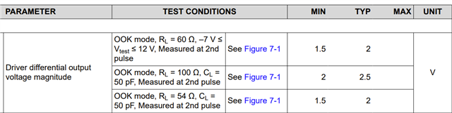

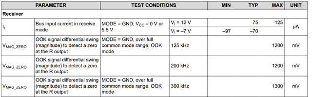

    As for the max wirelength, the one thing that I am concerned about is that for a fully loaded 54 Ohm bus, the max differential output magnitude will be 1.5V min and the Vmag_zero diff swing threshold is max 1.2-1.3V. The doesn't leave a lot of margin with long cable length attenuation. Am I missing something here?
  • Hi Yixing,
    If you need a higher carrier frequency, you will need to use the THVD8000.
    That is a valid concern, which I recommend that you test in your system to see how it exactly plays out. Your cabling, total RLC values, and number of nodes will affect the VOD. However, you can also remove or adjust the termination to lighten the load. You could achieve the 2 - 2.5V VOD depending on your loading conditions.
