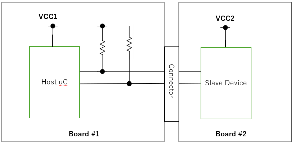

At my customer, a host uC is on the board #1, a slave device is on the board #2 and they are connected each other via a connector. In case VCC1 gets ON first while VCC2 is OFF(0V), they observe some voltage on the slave device I2C bus through the pull-up resister on the board #1.
To avoid this uncertain voltage on the slave device I2C bus, they plan to put a TCA4311A as follows. Does TI think this works as they plan?

    Let me correct their plan as follows. There are no pull-up resisters on the board #2.

  • Hi K.Hirano,
    I would recommend TCA9511A over the TCA4311A. The 4311A device has a missing ACK errata.
    A TCA9511A buffer would work well here by separating the two boards #1 and #2. The buffer would connect board #1 to board #2 only when both VCC1 and VCC2 are powered up.
    Tyler

  • Hi K.Kirano,
    My recommendation is to work to register the TCA9511A rather than TCA4311A. There is no p2p option to replace the TCA4311A with the current list given.
    For similar functionality, I would use the TCA9617BDGKR as the buffer with A-side facing the Host uC and the B-side facing the Slave device. Then ensure that the buffer is disabled by its EN pin (held LOW) while the board #2 is being plugged in. Once both sides are idle, enable the TCA9617B buffer.
    Also, you would need to ensure the VIL of the slave device are compatible with the VOLB = 0.58V of the TCA9617B buffer.
