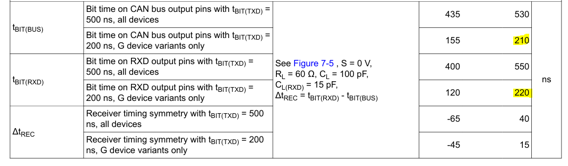

The first page of  TCAN1051HGVDR datasheet it claims 5Mbps support.
However, at page 12, Tbit max is 220ns which corresponds to 4,54Mbps.
Can you please confirm the data rate?
Thanks in advance;
Anber
  • Hi Anber,
    Yes, 5 Mbps an be supported and the 220 ns timing is for the loop delay and not the signaling rate i.e., TXD shows 200 ns (5 Mbps) while the loop delay from TXD to the bus and back to RXD is specified as the 220 ns, thanks.
