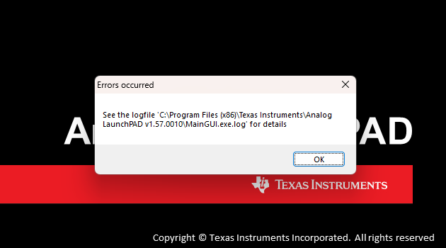

I'm experiencing problems when attempting to use Analog LaunchPad together with USB2ANY. The USB2ANY is the HPA665-001 model. When  I start ALP with the USB2ANY connected, I get an error message (see image). I am however able to get it to go into a demo mode if I start it without USB2ANY connected. This setup worked before and stopped working when I tried to install the ALP-profile_update. Since then I have attempted:

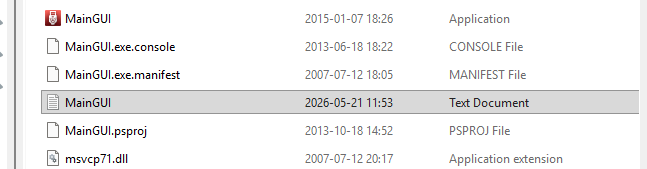

The .MainGUI.exe.log file is not visible in the referenced folder, only a MainGUI.txt which I appended here: MainGUI.log  The other image also shows what I see in .../Analog LaunchPad v.157.0010/....

A sidenote: I'm able to access the ALP GUI like normal, with everything working the first time after a fresh installation, but not afterwards. When closing it down and restarting it, it behaves like described above.
I'm not sure what has gone wrong here.. I suspect something has gone wrong during an installation process. I would appreciate any help!
