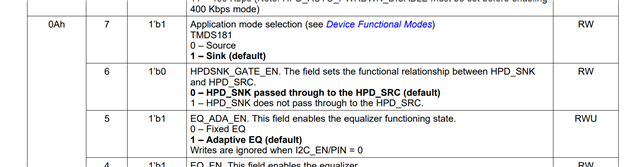

3. Precise Sequence to Halt/Freeze the Ongoing Adaptive EQ Loop
  • When Adaptive EQ fails to converge, we must immediately halt the automatic routine before applying manual parameters.
  • What is the exact step-by-step I2C sequence to completely freeze and terminate the internal automatic adaptive equalization state machine?

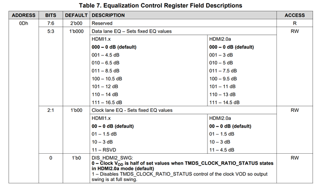

4. Transition Sequence to Fixed EQ Mode (7.5dB Mid-range)
  • After freezing the adaptive loop, we need to force Fixed EQ mode with a 7.5dB setting.
  • Please provide the precise register address and safe bitmask to force Fixed EQ and select the Mid-range value without corrupting critical default bits.
  • Which specific register bit must be toggled immediately afterward to initiate an instantaneous CDR re-lock based on the newly applied manual fixed EQ values?
    To stopped the adaptive EQ, this can be done using Page 0 register 0x0Ah bit 5 as shown below. Set bit 5 to 0 will change the EQ from adaptive to fixed.
    Please see my response in question #3. For fixed EQ, please see the table below. Once the fixed EQ has been set, the APPLY_RXTX_CHANGES bit (Register 0x0A, bit 4) needs to be set.
