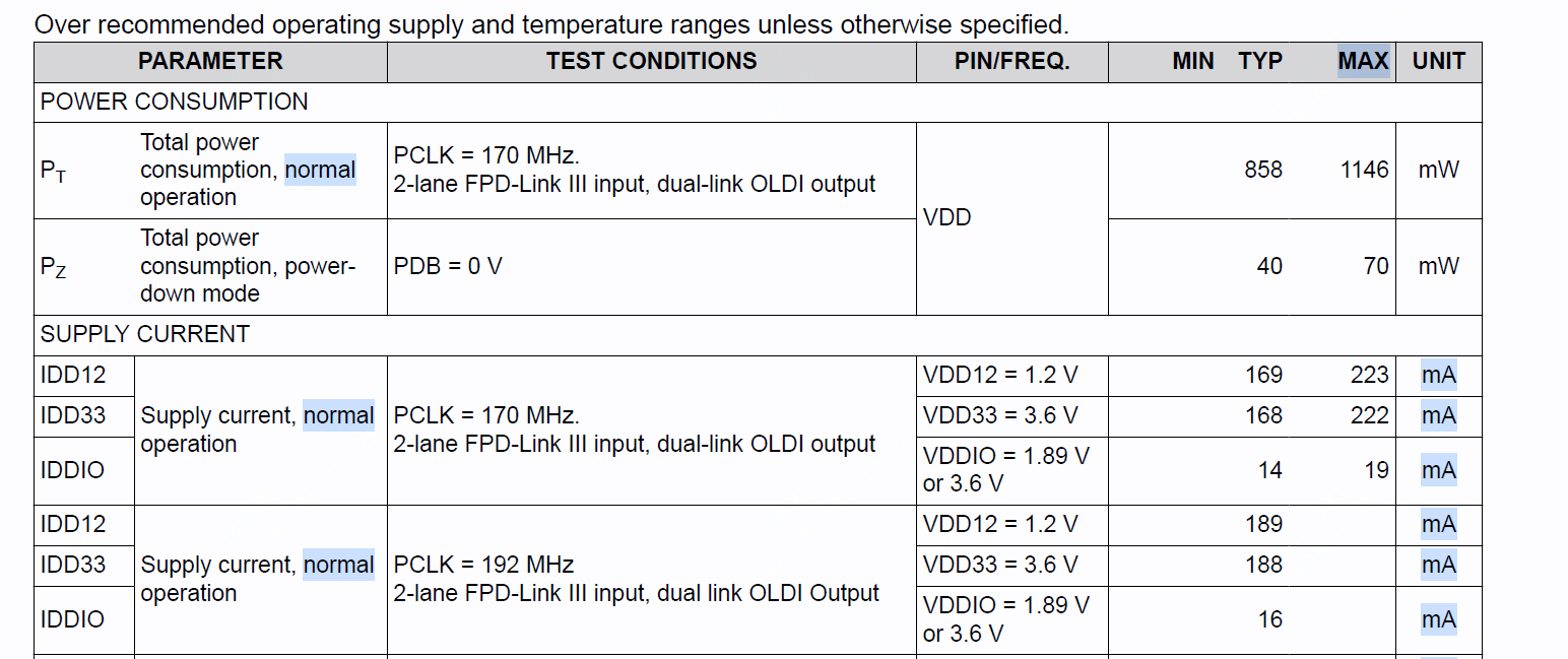

What is the maximum acceptable transient current for DS90UH948-Q1-VDD12/VDD33?

Hi Peiping,
Thanks for the question. Please follow the maximum current specifications in the PCLK = 170 MHz test condition for the PCLK = 192 MHz condition.
