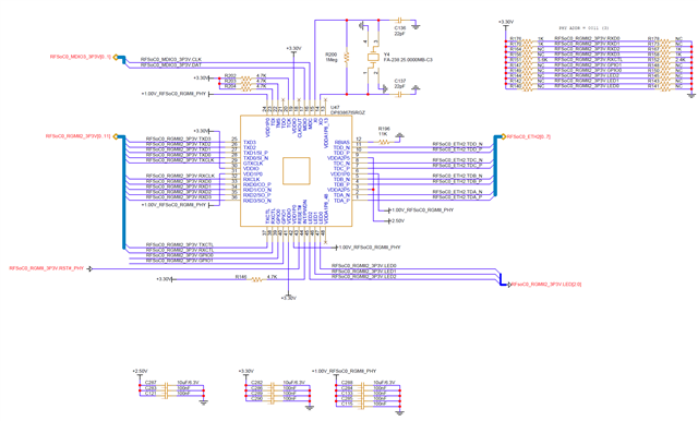

    In the register dump you shared, it can be seen that 0x0015 is measuring RX errors. This indicates the issue could be caused on the MDI side. Is it possible to share a schematic of the system? Are any issues seen with 88x3310 and other link partners?

  • Hi JH,
    I will review the schematic and respond with any comments soon.

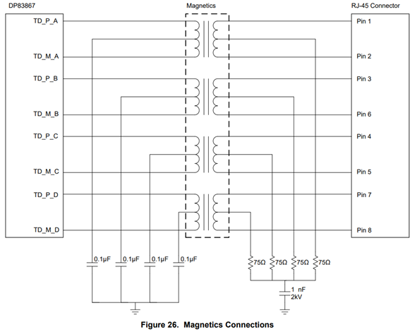

  • Hi JH,
    Apologies for the delay. Is there any additional schematic for the MDI configuration? It should be implemented as so -
    Please let me know if I am missing it in the attached pictures.

  • Hi Greg,
    Here is the customer's response.
    The circuit diagram previously provided includes the circuit diagram for component 2301996-7, which contains an RJ45 connector and a transformer. If you look at the 2301996-7 datasheet, you can confirm that it is designed as Figure 3.
    Please review the design to see if there are any errors.
    JH

  • Hi JH,
    I attached a schematic checklist with my comments. Pleas ensure all points on the checklist are followed.
    Greg
    DP83867_Schematic_Checklist_6_30.xlsx
  • Hi Greg,
    I have completed and attached the DP83867 schematic checklist.
    Some items are not applicable to our design, and there are a few minor differences, but nothing unusual stands out.
    Please review the checklist and let us know if you see any potential concerns.
    DP83867_Schematic_Checklist_6_30_checked.xlsx
