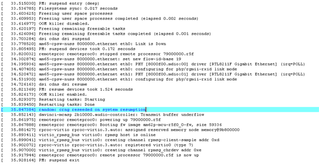

kmsprint
root@am62pxx-evm:~# kmsprint
Connector 0 (42) DSI-1 (connected)
  Encoder 0 (41) NONE
    Crtc 0 (40) 800x1280@44.32 50.000 800/30/8/4/- 1280/20/20/20/- 44 (44.32) P|D
      Plane 0 (33) fb-id: 51 (crtcs: 0) 0,0 800x1280 -> 0,0 800x1280 (AR12 AB12 RA12 RG16 BG16 AR15 AB15 AR24 AB24 RA24 BA24 RG24 BG24 AR30 AB30 XR12 XB12 RX12 XR15 XB15 XR24 XB24 RX24 BX24 XR30 XB30 YUYV UYVY NV12)
        FB 51 800x1280 XR24
kmsprint displays the correct resolution, and there are no errors reported for tidss 30200000.dss. However, there is no signal output from the DSI interface.

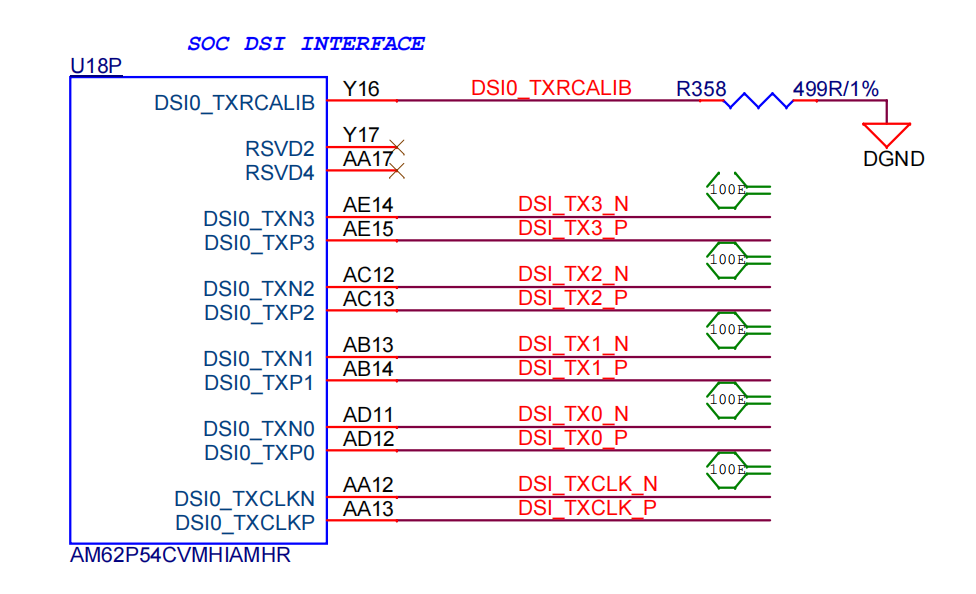

DSI output schematic diagram:
How can I configure to enable DSI output signal?
