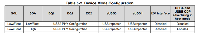

  • Hi Koyo,
    How are the EQ and SDA/SCL pins configured? Could you provide the customers schematic?

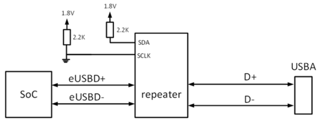

    In order for CDP functionality to be enabled, the SDA pin must be pulled up to 1.8V:

  • Hi Ryan,
    SDA/SCL connection is already shown. My understanding is EQ setting is for USB2 PHY so it dosn't impact to CDP.

    Here's the image of connection. SDA is pulled up by 1.8V and SCL is short to GND.
    EQ0 is pulled up by 1.8V and EQ1/2 are pulled down.

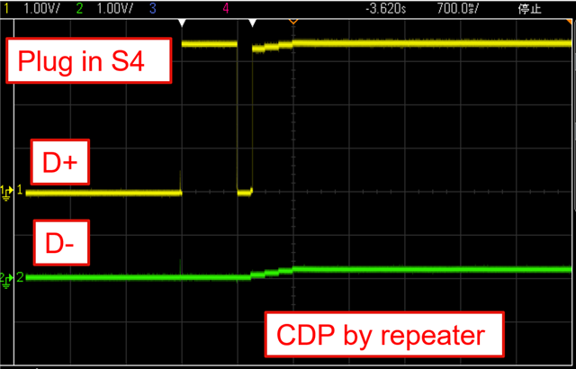

    He has another question that CDP is working as expected in both S0 and S4 states but the waveform in S4 is different than he expected. Do you see the reason why D+ and D- are not 0.6V but working correctly?

    Waveform in S4. CDP is working but the waveform is different.
    (S4 = Windows is supended but USB power is ready to supply)
  • Hi Koyo,
    Per the BC1.2 spec, a portable device is able to draw up 1.5V when connected to a CDP, regardless of configuration or rules of suspend:
    The waveform in S4 is likely the device following that behavior. Just curious, when windows comes out of suspend, does a BC1.2 handshake occur? Could the customer capture this to check?
