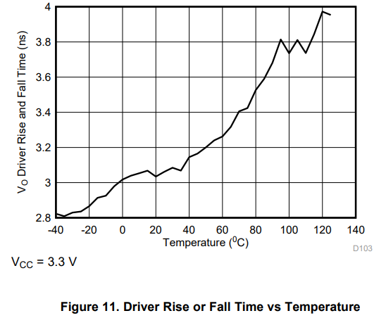

We are using the THVD1452DGSR in a new product and found that it is not performing to the datasheet specification.
Per document SLLSEY3E (revisied may 2019) section 7.8 for part THVD1452 it states that the Differential output rise/fall time  (tr, tf) should be within 1 to 6ns. This is further then further clarified in figure 11 for 3.3V and timing characteristic in figure 22.
When I measure the output with RL=54 ohms from B to A on the driver output I am getting 18.15ns as seen in the picture below. This is out of the product specification for the THVD1452DGSR, and have verified the marking on the part matches the what the datasheet says.
What specification for the driver / reciever rise and fall?
Section 7.8 specification
Figure 11 temperature affect of tr, tf
Figure 22 measurement of tr, tf

    A2.) I am using 3.3V and not 5V for my VCC. Looking at Figure 11 in the datasheet, I would expect that the 3.3V specification to still be less than 6ns.

    I did go ahead and check in our internal database for what values they measured when used at 3.3V and found the data showed it was around 2ns. I'm not sure what is the exact difference between your test set up and their is.
