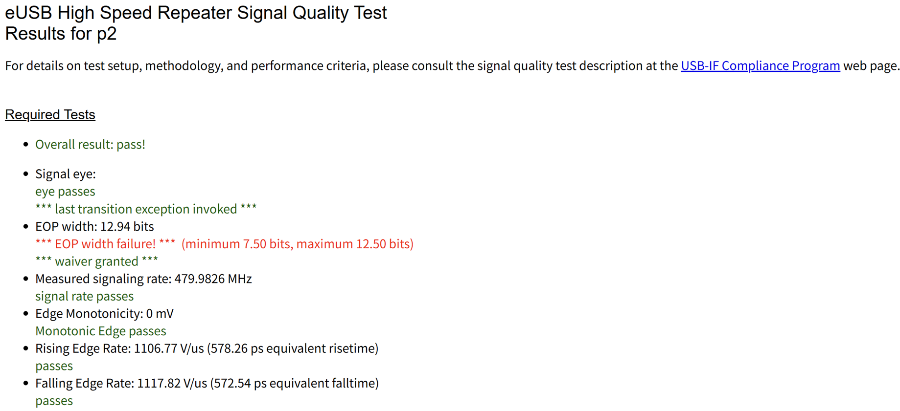

My customer got one eUSB high speed repeater sighal quality test fail, could you help to check why?
  • EOP width test failed for Port 2 (Type-C) and Port 4 (Type-A) during USB 2.0 testing.(FR:3/3u,1/1cycles)
