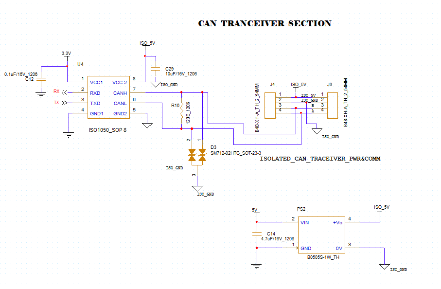

I am planning to design a new circuit using the ISO1050DUBR isolated CAN transceiver. Could you please provide information regarding its EOL (End‑of‑Life status and long‑term availability)?
Additionally, I have prepared the circuit schematic below. I would appreciate it if you could review the design and provide technical feedback.

  • Hi Sriram,
    Thanks for reaching out.
    There's no EOL planned for this device currently, and if planned - it will be notified well in advance to all the customers. This is strictly followed as per TI policy mentioned here  - Product life cycle | TI.com
    On the schematic connection:
    1. Please add an additional 0.1uF capacitor on VCC2, preferably an 0603.
    2. Use a higher DC rated capacitors for all the supply decoupling capacitor, min 25V to recommended - the motive is to compensate for the DC bias derating of the capacitors.
    Varun

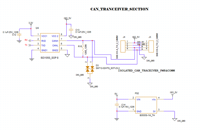

  • Hi Varun,
     Thank you for your feedback. I have updated the schematic as requested: • Added a 0.1 µF capacitor (1206 package) on VCC2. • Changed all supply decoupling capacitors to a minimum 25 V rating to account for DC bias derating.
    Kindly review the revised schematic and let me know if any further changes are needed.

  • Hi Sriram,
    I suggested to have both 0.1uF+10uF on VCC2. Do not remove 10uF cap from VCC2.
    For 0.1uF, it is better to have smaller package like 0603 for lower parasitics.
