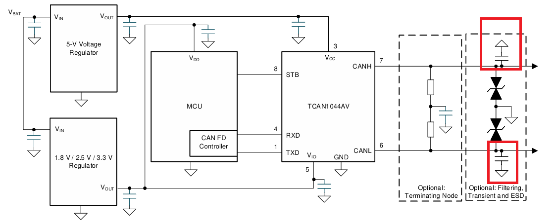

 We are in the design phase of our project in which we are using the part TCAN1044AVDRBRQ1image.png
In the above application circuit, capacitors are connected individually to a common ground. I need to confirm whether this capacitors are need to connected together as given below:
please confirm the above and also please share the necessary details for designing esd protection in CAN bus(TCAN1044A-Q1)?
