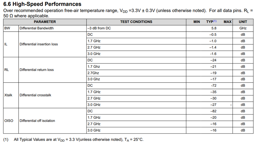

Please help TS3DV642A0RUAR circuit confirmation,cause the CLK Switch only has I2C as a working connection, I'm wondering if this will have any impact.

  • Hi
    We are concerned about a potential bandwidth limitation issue since the DSI CLK is connected to the switch IC's I2C pins. Please help confirm if this configuration is completely okay. Thanks!
  • Hi Kevin,
    The TS3DV642-Q1 supports differential bandwidths of -3dB from DC up to 5.8GHz so there should not be any bandwidth issues.
    Since you are using it for a DSI based application, I would recommend connecting the DSI CLK+ signal to the switch ICs HPD pin and the DSI CLK- signal to the CEC pin as shown in the datasheet's systems examples for DSI switching below.
