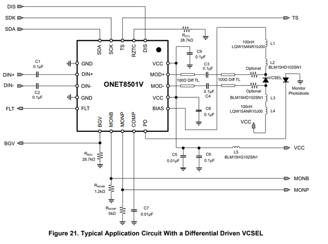

ONET4291VA: ONET4291VA VCSEL Application Schematics
Part Number: ONET4291VA
Other Parts Discussed in Thread: ONET8501V
I was wondering if there were more design documents/application notes avaliable for the ONET4291VA. The datasheet only provides a schematic for a VCSEL being driven in a single ended common cathode configuration, is there an application schematic for the differential drive configuration?
