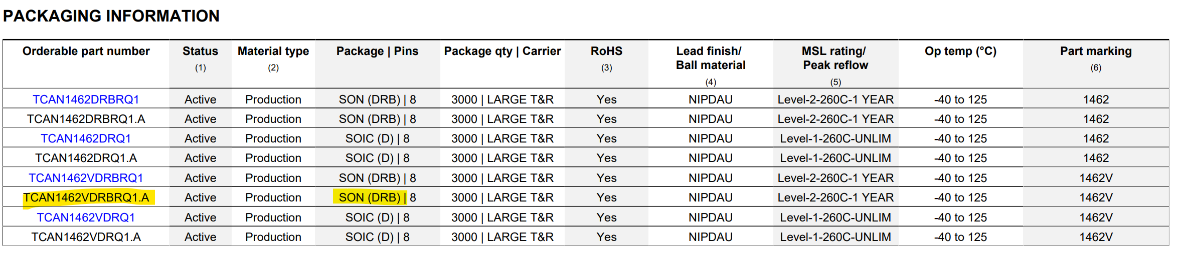

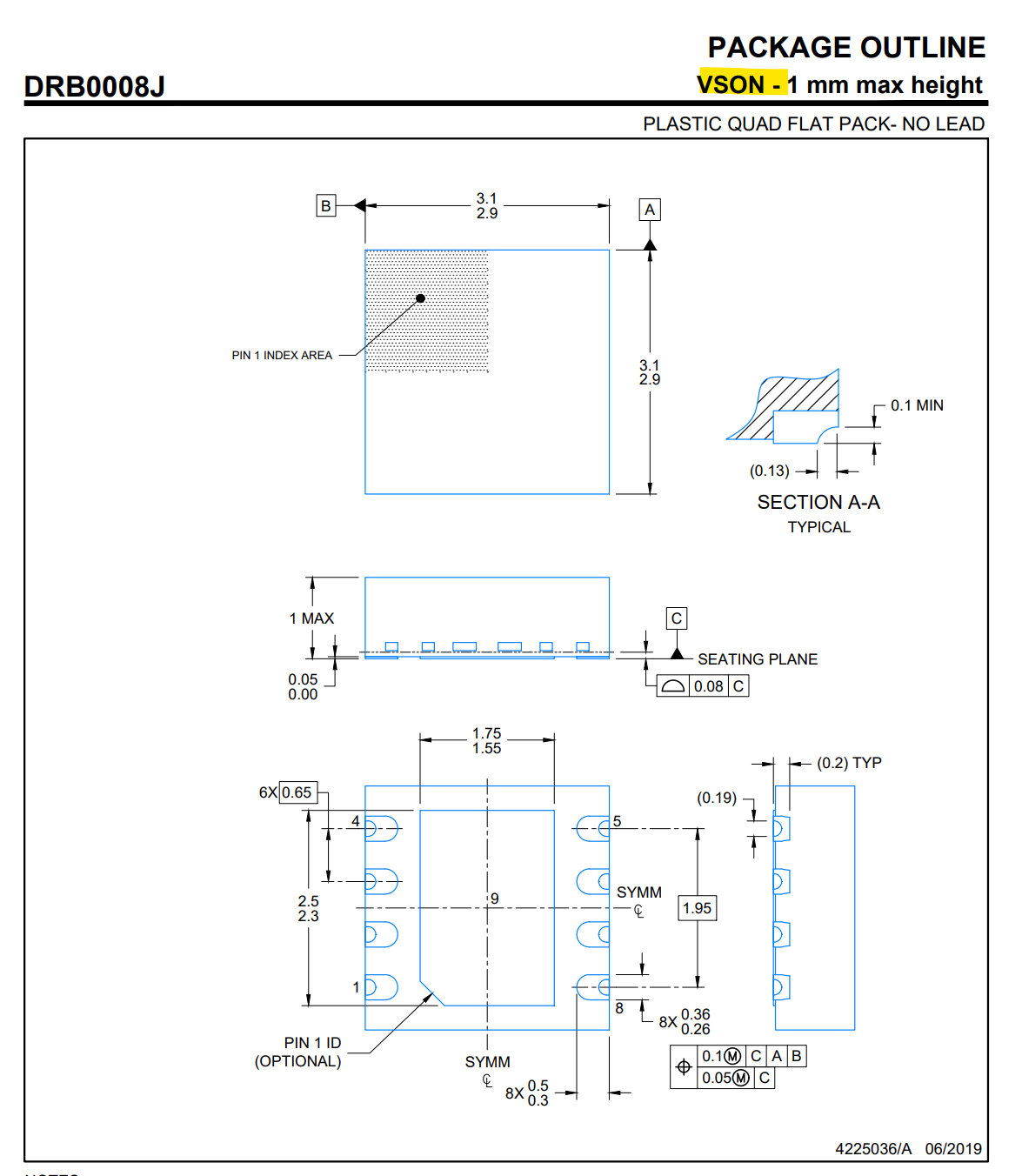

Hi team,
Could you please help to clarify the package information
Is TCAN1462VDRBRQ1 SON-8 or VSON-8?
Thanks.
