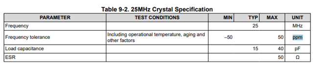

  • Hi Nir,
    If the crystal I included is suitable for the DP83826 why do I need to add a resistor?
    The crystal has the correct specs for ppm, frequency and load capacitance such that It fits this table in our datasheet:
    This means that the PHY can work with this crystal. The resistor is more for ensuring long term reliability of the crystal rather than a spec needed for the PHY.
