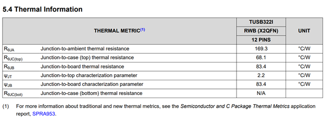

Hi Frank,
Here are the thermal metrics from the datasheet:

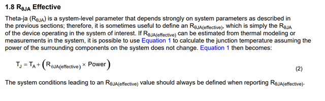

Please be aware of the following:
The method to approximate junction temp is as follows:
Hi Vishesh,
Thanks for the comments, but I am wondering what is the allowable range for junction temperature for TUSB322I?

Hi Frank,
As Theta-ja is a system level parameter that depends strongly on system level considerations such as layout, its difficult to provide a range.
A very simplified range can be derived from the equation shared above:
TJ = Ta + (theta-ja x power)
TJ = 85 + (169.3 x 0.000231) from 70uA current consumption x 3.3V
TJ = 85.039.
This is approximately equal to the ambient temperature range, so the junction temperature range will be approximately equal to the ambient temperature range.
However, keep in mind that the Theta-ja will change based on implementation.
