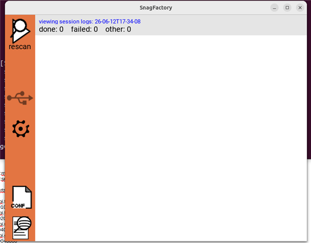

      Recover cmd,
    sudo /home/.local/bin/snagrecover -s am6442   -F "{'tiboot3': {'path': '/home/ti-processor-sdk-linux-rt-am64xx-evm-12.00.00.07.04/u-boot_build_custom/tiboot3.bin'}}"   -F "{'tispl': {'path': '/home/ti-processor-sdk-linux-rt-am64xx-evm-12.00.00.07.04/u-boot_build_custom/tispl.bin'}}"   -F "{'u-boot': {'path': '/home/ti-processor-sdk-linux-rt-am64xx-evm-12.00.00.07.04/u-boot_build_custom/u-boot.img'}}"
    2026-06-12 17:32:56,841 [ERROR] Device access error: failed to access USB device 0451:6165, please check its presence and access rights
    I am getting below error,
    I am not able to detect my am6442 board.
    I used snagfactory.config and generated tiboot3.bin,u-boot.img, tispl.bin  and used for below portion
    soc-models:
      am6442-firmware:
        tiboot3:
          path: "/home/asmgen2/ti-processor-sdk-linux-rt-am64xx-evm-12.00.00.07.04/u-boot_build_custom/tiboot3.bin"
        tispl:
          path: "/home/asmgen2/ti-processor-sdk-linux-rt-am64xx-evm-12.00.00.07.04/uboot_build_custom/tispl.bin"
        u-boot:
          path: "/home/asmgen2/ti-processor-sdk-linux-rt-am64xx-evm-12.00.00.07.04/uboot_build_custom/u-boot.img"
    And actual working files build for ospi is used in below portion:
    - task: flash
        args:
          - image: "/home/asmgen2/ti-processor-sdk-linux-rt-am64xx-evm-12.00.00.07.04/asm_images/tiboot3.bin"
            part: ospi.tiboot3
          - image: "/home/asmgen2/ti-processor-sdk-linux-rt-am64xx-evm-12.00.00.07.04/asm_images/tispl.bin"
            part: ospi.tispl
          - image: "/home/asmgen2/ti-processor-sdk-linux-rt-am64xx-evm-12.00.00.07.04/asm_images/u-boot.img"
            part: ospi.u-boot
          - image: "/home/asmgen2/ti-processor-sdk-linux-rt-am64xx-evm-12.00.00.07.04/asm_images/k3-am642-evm.dtb"
            part: ospi.dtb
          - image: "/home/asmgen2/ti-processor-sdk-linux-rt-am64xx-evm-12.00.00.07.04/asm_images/Image"
            part: ospi.kernel
          - image: "/home/asmgen2/ti-processor-sdk-linux-rt-am64xx-evm-12.00.00.07.04/asm_images/am6-sdk-tiny-fs.ubi"
            part: ospi.rootfs
