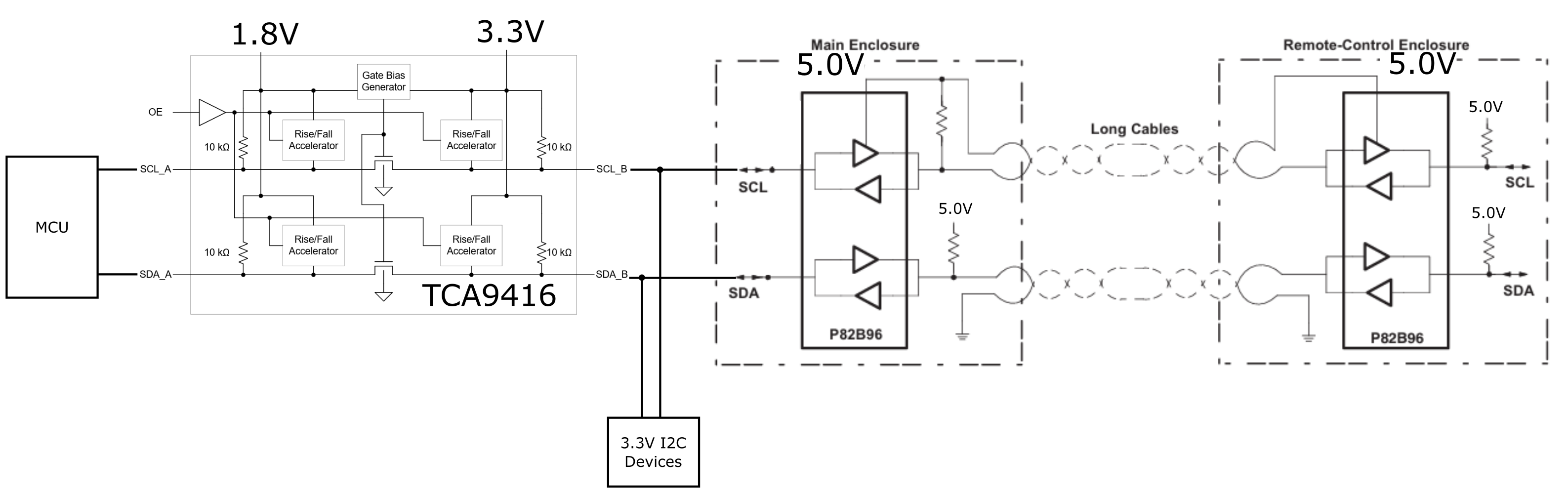

Will I run into any issues using the P82B96 with the TCA9416 in a setup like this:
The TCA9416 is a "switch type" voltage translator, so I believe it will be fine, but I would appreciate a second look.
  • Hi Phillip,
    P82B96 is VIT input threshold is independent of the supply voltage.
    A 3.3V supply from the TCA9416 should allow the P82B96 to work properly even though a 3.3V input is being applied instead of 5V.
    The problem with this setup is actually when driving a logic low from the remote control enclosure side. The output voltage of Sx,Sy terminals is max of 1V. This means the MCU will see approx vol = 1 V which the MCU is based off 1.8V. I think you would need some type of buffer in place of the TCA9416.
    Can you opt for using TCA9803 with B-side facing the MCU, and A-side facing the P82B96?
    Tyler
  • Hi Tyler,
    Thanks for the answer. Good catch on the Vol from the P82B96.
    The MCU is a SOM that has integrated I2C pull ups, so I can't use it with the B side facing the MCU.
    Regardless, wouldn't this solution have the same issue with Vol of the P82B96 being potentially greater than the Vil of the TCA9803:
  • Hi Phillip,
    The VOL of P82B96:
    Technically a max of 1 V, if you adjust the pull-up resistors to sink 3 mA. VILA for TCA9803 = 0.3 x VCCA = 0.99V max. There is technically 0.01 V outside spec if looking at the max.
    If you adjust the pull-up resistors on Sx/Sy side to 0.2 mA, your max drops to 0.79V, which fits within the spec of the TCA9803.
    Your B-side output voltage of the TCA9803 that faces the MCU is:
    This is much lower than the P82B96.
    Tyler

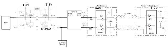

  • Hi Tyler,
    Could I just add a TCA9517 inbetween the P82B96 and the 3.3V I2C bus to solve this issue?
    (A side of TCA9517 on 3.3V side, B side on 5V side)
    Phillip
  • Hi Phillip,
    The B-side input of TCA9517 is 400mV, so the large offset from P82B96 would be incompatible.

  • Hi Tyler,
    I'd like to keep the TCA9416 in place for some schematic reuse purposes.
    What about adding the TCA9509 to the bus just to drive the P82B96 like this:

  • Hi Phillip,
    Sorry about the delay, I totally did not get back to you when I said I would.
    It is generally not recommended to have rise-time or fall-time acceleration on the static offset side (A-side) of the TCA9509, however, I can't find a description in the datasheet recommending this.
    Due to the low VILC requirement of the TCA9509, I would recommend removing all external pull-up resistors on A-side and B-side of the TCA9416. Rely only on the integrated 10k PU resistors and the 1mA current source of the TCA9509 on A-side. The MCU needs to be able to pull low enough to have VOL < 150 mV in order to meet the input voltage to the TCA9509.
