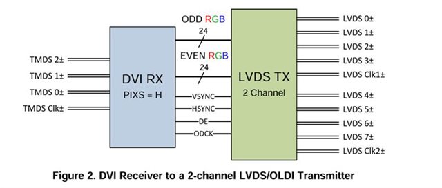

I am looking for an IC equivalent to DS90C387A, but with a wider operating temperature range.
Are there no plans to release anything new in the future?
The mandatory requirement is that the device must support a configuration like the block diagram shown below.
Do you have any recommended device for this requirement?

    There are a wide variety of FPD-Link devices that feature a wider operating temperature range. Unfortunately, the block diagram did not upload correctly. Can you please try re-uploading so we can determine the most appropriate devices for your customer?

  • Hi Nikolas-san,
    I'm sorry. The image is below.
    Shota
  • Hi Shota-san,
    Unfortunately, we do not have a DVI receiver (serializer) in our portfolio that would support an expanded operating temperature range.
    We do, however, have multiple LVDS transmitters (deserializer) in our FPD-Link portfolio that would support a wider operating temperature range, so if the receiver can be swapped out in order to receive a different video input, then we could identify an appropriate set of serializer and deserializer devices for your customer.
