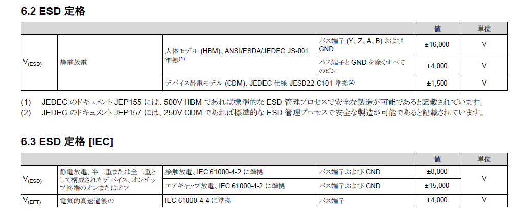

Regarding the THVD1424 datasheet, Section 6.3 "ESD Ratings [IEC]", the device is specified as:
IEC 61000-4-2 Contact Discharge: ±8 kV
IEC 61000-4-4 EFT: ±4 kV
Could you clarify what acceptance criterion was used to determine these ratings?
For example, are these ratings intended to indicate:
No permanent damage to the transceiver (device survives the test), or
Compliance with a specific IEC performance criterion (A, B, C, or D)?
In other words, during the IEC 61000-4-2 and IEC 61000-4-4 tests, was normal communication operation maintained, or was the criterion simply that the device remained functional after the test?
Thank you.
