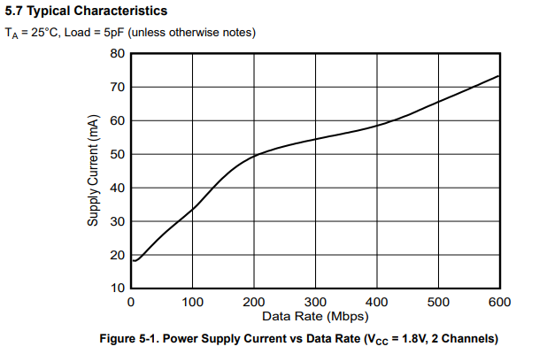

The maximum supply current of D9LVRA2DEMRQ1 stated in the datasheet is 25mA. Our customer would like to know the typical supply current.

Hi Danilo,
This will depend on your data rate. See below:
