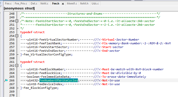

Hi Team, want to know whether FEE module provided by TI supports configuration of a required number of write cycles for each logical block. I found a configuration paramenter "FeeNumberOfWriteCycles" in Fee.h file under "Fee_BlockConfigType" tag but the same parameter is not used in source code.
MCAL version: MCAL_MSPM0_00.09.00.00
  • Hi Aniket,
    I recommend to upgrade to the latest MCAL version (i.e. MCAL_MSPM0_01.00.00.00).
    However, TI does not support the configuration of a required number of write cycles for each logical block. The FEE module protects flash longevity through its virtual sector wear leveling algorithm, not through per-block cycle tracking. The variable you mentioned it is used to comply to the AUTOSAR interface, but it is informational only and the driver does not enforce a per-block write cycle limit.
