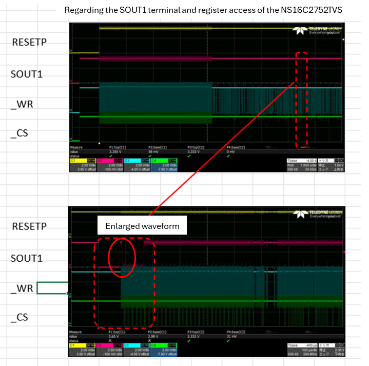

An abnormal behavior has occurred with the SOUT1 terminal of the NS16C2752TVS.
Specifically, a problem occurred where communication with the SD card was not possible immediately after the NS16C2752TVS was started up.
Please see the dollowing questions an waveform.
1)A problem occurred where communication with the SD card was not possible immediately after the application was launched.
  Is it possiblity for SOUT1 to spontaneously go low even if no register access is performed after POR startup?
  Also, is it possiblity for the TX line (SOUT1) to change between High-Low-High during register initialization?
  Please see the enlarged waveform.
2)Are there other instances where the TX line(SOUT1)toggles once after a certain period of time has passed since powering on, without changing the register settings during initialization?
   For example, is there a way to prevent this toggle phenomenon by adjusting the register settings?
