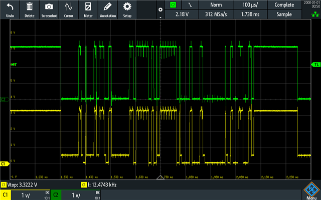

    I tested only the sensor side with STM32 NUCLEO-G474RE to ensure sensors are working. The sensors worked just fine with 2K2 pullup resistors at both 100kHz and 400kHz I2C frequencies. But one sensor was not working. After investigation we determined that one sensor's SCL and SDA lines were soldered in reverse.
    After fixing the sensor connection our system worked at 100kHz. But not worked properly at 400kHz.
    R63 and R64 not populated. 2k pullup resistor soldered between 3V3.GR1 and SCL, SDA lines.
    C1: Sensor Side, C2: Host Side
    100KHz SDA Line
    400kHz SDA Line

    I have tested with NUCLEO-G474RE and 1K pullup resistor. Sensor side working fine with 400kHz. Here is the waveforms:

    As the board with the MSPM0G3519 is functioning and NUCLEO-G474RE is not, it would indicate that investigation on the second MCU should looked further. From the waveforms, the rise times are a bit slower (which can be remedied with using stronger external pullups), though I do not see anything alarming on the waveforms which you provided (i.e false logic high/low signal), otherwise please help to clarify the specific concern is.

    I tested sensor side with LP-MSPM0G3519 EVM. It works both 100kHz and 400kHz. Here is the signal:

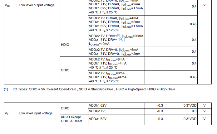

  • Hi Jack,
    We are using MSPM0G3519 MCU on the host side. We supply the MCU with 3V3. Here is the VIL/ VOL:
    Datasheet, 7.10.1 Electrical Characteristics
    VOL : 0.4V Max
    VIL  : -0.3V Min, 0.8V Max
  • Hi Mesut,
    With the TCA9517 interfacing this device on the B-side, the VOL of 0.54V would still be accepted into the MSP as it is less than 0.8V max, and the VOL of the MSP is also within the max VILC on B-side.
