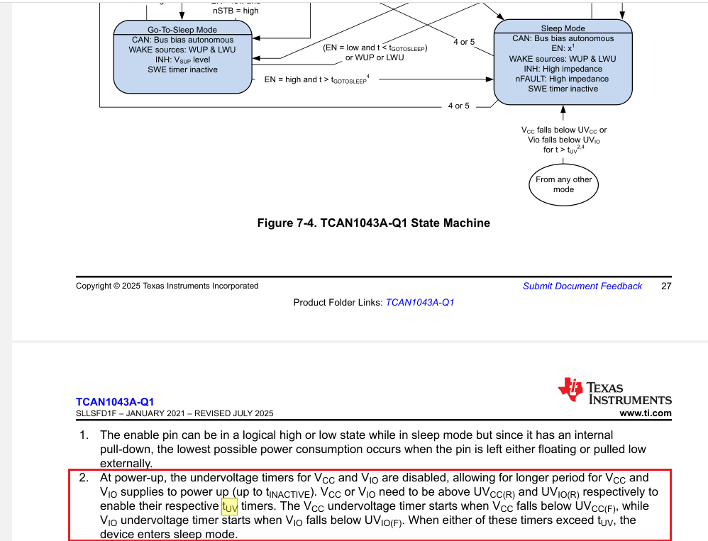

Hi team,
Does TCAN843 have same feature like TCAN1043A? Thanks!
