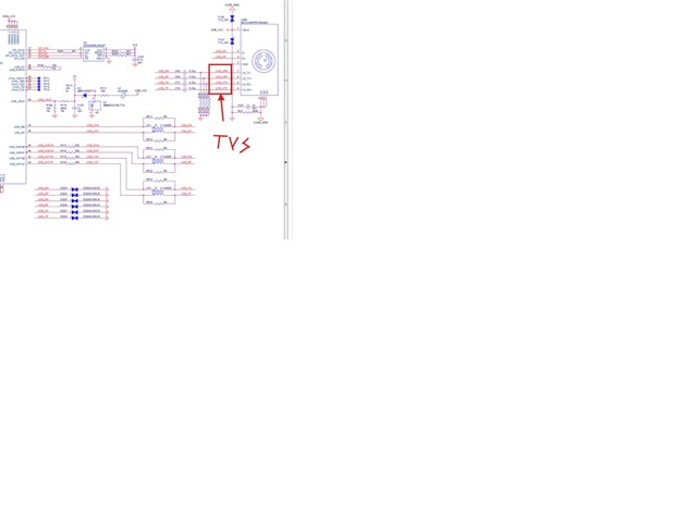

Hi Gareth,
Please use the following app note to help you with ESD selection for USB interfaces: https://www.ti.com/lit/an/slvaf82b/slvaf82b.pdf?ts=1781705400967&ref_url=https%253A%252F%252Fwww.google.com%252F.
Regarding your second request, unfortunately we do not have any TVS High Power devices in our portfolio yet. Apologize for the inconvenience.
Bryan
Can you share Datasheet of downstream IC protected? It's quite blurry and hard to see.
ESD diode should be above 32V, so our only low cap solution is ESD801 https://www.ti.com/product/ESD801. Typ cap is 0.3pF.
Can you also share application, end equipment? This is good to have for reference.
Bryan
