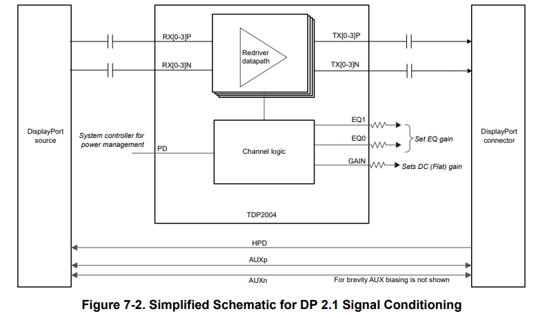

BYD is considering to use DP redriver to drive Automotive display, the cable between DP source and sink is around 2m. From data sheet, I saw we can support cables. Here are some questions:
  1. We only have DP data input, but no AUX input. Doesn't Aux need redrive? I also saw TDP142 has AUX pin, but it's not Q grade.
  2. For TDP2004-Q1, do you recommend use I2C mode or pin mode for automotive display usage?
Thanks!
    Please see my inserted response below.
      1. AUX is a 1Mbps Manchester Encoding bus. With its low speed 1Mbps data rate, typically AUX re-driving is not needed since insertion loss at 1Mbps will be very low. TDP142 has AUX pins, but they are used for power management function, not for re-driving function.
      1. I2C mode will require either an EEPROM (I2C Primary Mode) or an I2C controller (I2C secondary mode). Either EEPROM or I2C controller will be Q1 graded which adds additional cost. Pin mode only needs couple resistors. You can tune the TDP2004-Q1 in I2C mode secondary mode first, and then lock the same setting using pin mode.
    BYD want to use this DP redriver to replace SerDes in the automotive display, so there is cables between DP source and DP sink. Based on your experience, how long cables between source and sink we can use when AUX doesn't redrive? Thanks!
    BR
    Jiawei
  • Jiawei
    Depending on the required data rate, I would refer BYD to the specific DisplayPort specification, especially the section on the cable insertion loss spec. If their cable insertion loss is below the spec at the particular data rate across the frequency domain, then I would expect AUX to work with their cable.
