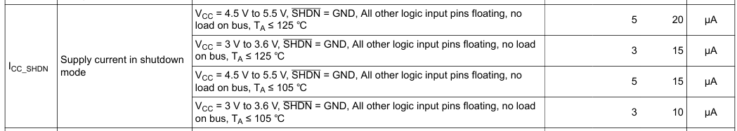

Hello there,
The THVD4411 datasheet lists the typical shutdown current as 10 uA. Is "typical" a typo and should it be "maximum" instead? The datasheet shows the following for I_CC_SHDN where I don't see any 10uA for typical but I do see 10 uA in one case for maximum.
Joseph
